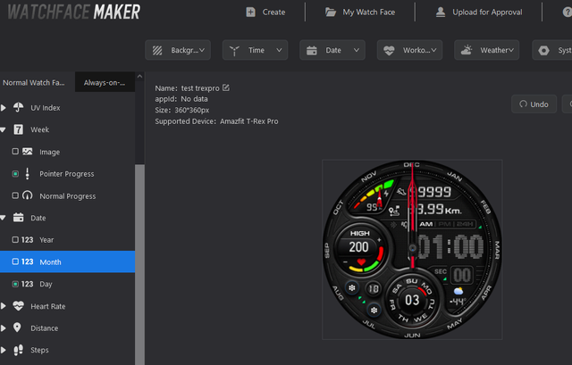

This watch face is created from the official edit tool.Fearless-Week wrote: 26 Oct 2022, 00:24Thanks for answering asoo!. I tried what you said, with the preview file as 0002, corrected every value and still have a black screen. In T-Rex Pro (I think) 0001 must be the background image.
Here is the file, corrected with the preview image as 0002, in case someone would like to test it.
Since the official edit tool doesn't have a month pointer, this dial doesn't have a month pointer.
you can try installing this watchface on your watch to check it work or not , If it works, try to fix it with SashaCX75's request tool again.

Seems like that editor make this skin work. Thanks! Im going to try to fix the month pointer with the SashaCX75's editor and then I will report what happend
EDIT
Seems like its the SashaCX75 pack the skin differently, with your edition now the skin works!!
Thanks so much!. Now I will need to find that editor you are using. Thanks again!

official editer :Fearless-Week wrote: 26 Oct 2022, 14:39Thanks so much!. Now I will need to find that editor you are using. Thanks again!Spoiler
EDIT
You must be registered with zepp to use it.
https://developer.zepp.com/os/home
