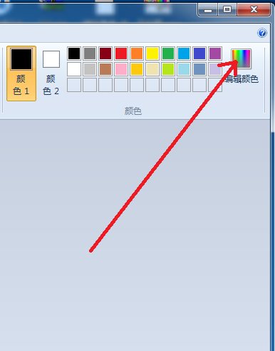

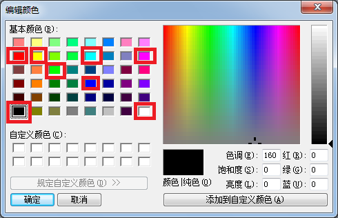

I am a new watch face designer. I use Windows paint application to color watch face objects. However, color warnings appear when a watch face is being compiled. I am not sure whether 8 or 16 bit color should be used. For example how to apply 8 bit red color with windows paint? Any suggestion is appreciated. Thanks.

The position and style of the tool icon in the 【Windows paint application】 are the same.asadulhuq wrote: 15 Feb 2019, 16:11I am a new watch face designer. I use Windows paint application to color watch face objects. However, color warnings appear when a watch face is being compiled. I am not sure whether 8 or 16 bit color should be used. For example how to apply 8 bit red color with windows paint? Any suggestion is appreciated. Thanks.

asadulhuq wrote: 16 Feb 2019, 11:59Thanks for hints. But Chinese characters in the application is a problem for me.

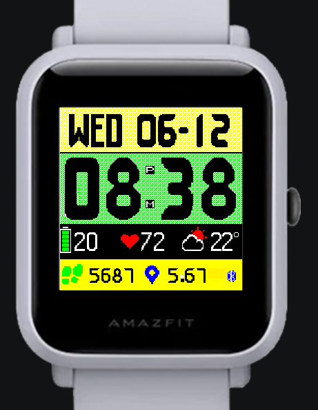

I get following error/warning and hence compilation of the watch face cannot be completed. You may please notice the watch face image below which I am trying to compile.
Debug|Reading config...
Debug|Reading referenced images from 'C:\Users\Asadul Huq\Desktop\MyBIPFace\NEWFace\1528565345112'
Trace|Loading images for 2 'Background'
Trace|Loading images for 2.1 'Image'
Trace|Loading image 0...
Trace|Image was loaded from file C:\Users\Asadul Huq\Desktop\MyBIPFace\NEWFace\1528565345112\0000.png
Warn|Dithering applied for an image. Resource in watch face will u
se only supported colors. You can't get back original image by unpacking watch face.
Trace|Loading images for 3 'Time'
I cannot figure out exactly how to choose an acceptable color. I am using windows Paint application.
Any information regarding this problem is appreciated.
