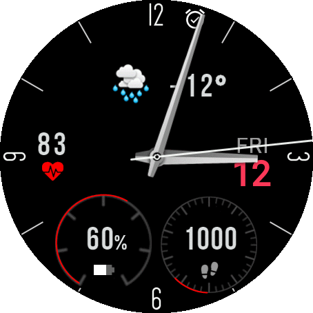

Left: old image format from falcon watchface
Mid: new image format for GTR mini converted by zepp official watchface editor
Right: new image format for GTR mini converted by using image converter tool (force use the improved algorithm)
