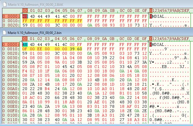

How to HEX your .BIN to use in "watch skin local" of Mi Fit
1. open your .BIN with HexEdit ( https://www.dropbox.com/s/hmqdynh8dl0lj ... t.zip?dl=0 )
2. on bytes 17 to 24 edit FF FF FF FF FF FF FF FF to 0F 00 EE 00 00 00 39 60 and save 3. Now your .BIN can use in "watch skin local" of Mi Fit

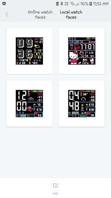

How to use "watch skin local" ( Local watch Face )
1. Folder of "watch skin local" is /storage/emulated/0/Android/data/com.xiaomi.hm.health/files/watch_skin_local/
2. make new folder in "watch skin local" ( one folder for one watch face )
3. Copy modified youreWatchface.BIN and yourWatchface.jpg or png or gif in your new folder
4. Now open Mi fit and go to "Local watch Face" you can see your Watcface --------------------------------------------------------------------------------------------------------------------------------------------------

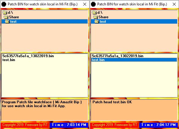

I write a small program for patch bytes 17- 24 of BIN with VB . ( for Windows)
The program will work by patch FF FF FF FF FF FF FF FF to 0F 00 EE 00 00 00 39 60
use by Double click on file.BIN in screen 2
If you can't use hex, you can try using my program to patch BIN

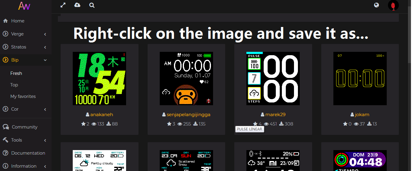

Right-click on the image and save it as...JohnM wrote: 08 Mar 2019, 23:36I down loaded the bin, modified it via hex editor, copied to a new folder in /files/watch_skin_local/ but it does not show up under local. Also, there is no .jpg or png or gif included when down loaded. So, I assume that may be the problem but do not know where to get the face gif. Any help would be appreciated.

You can try to save GIF as PNG by using the drawing program of WIN system.JohnM wrote: 10 Mar 2019, 02:28Thanks for the reply about right clicking the face and saving. I did that and moved the face and modified .bin to a new folder in local but it does not appear. What should I try now?

This worked very well! Thanks! A great workaround to see and install WF via official program.romstemp wrote: 14 Feb 2019, 12:06If you can't use hex, you can try using my program to patch BIN
