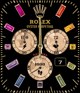

This almost perfect but I would like the time to be white!
How in the hell do you do these request so fast?? 🤣😁😁

Hi, I'm having difficult times creating my watchface with those tools shown above.
so exhausted...
I would be happy if anyone could look over my bin file and create a proper watchface bin.
What I've done is
1. Unpack downloaded bin from catalog using main_mini.exe.
2. Modify and also create some new images using Photopea.
3. Reduced the size of png using "https://compresspng.com/".
4. Using offline editor(not Huaim) to edit jason.
5. Pack with main_mini.exe and finally get my watchface.bin and other animated gif and else.
6. Install bin via amaztool.app (iOS).
Install successed but the images didn't show on the watchface and crushes...

juno-san wrote: 15 Jun 2022, 02:08
so exhausted...
What I've done is
rol_rainbow_packed.bin
to PackUnpack bin, I've also tried to use this tool (viewtopic.php?p=10807#p10807) instead but the result was the same.
First of all let me tell you that I don't have gts2min so I can only check the scritp and resource section.
from the inspection I can't find any abnormality in script "json".
but in resource images section based on the information you provided you get compress png
So I think the problem might be from this part.
Since the device has a specific png format, it may result in the image that you compress the device to be unreadable.
I recommend using a normal PNG image that doesn't have compress.
The PNG I am using has the following format:
Examples that have been uncompress png
I'm not sure if I can work because I don't have GTS2MINI.
But in the "pack process" it's without any error
rol_rainbow_packed_packed.bin
(393.94 KiB) Downloaded 176 times

Thank you so much and I finally made it!
I changed my png format from using palette to truecolor.
also about my jason file, I found that I didin't add preview block. what a laugh...
