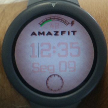

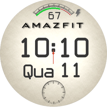

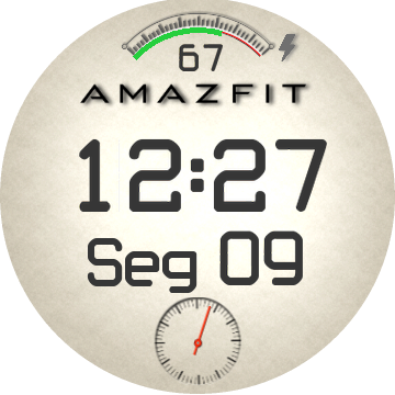

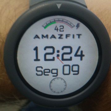

Hi, first time posting. This is an amazing community! I got my Verge Lite just a week ago and I already am making lots of progress just lurking around.
I'm designing my wf and I'm facing a problem with the mini seconds handle, I hope you guys can help.
This is the preview generated by Amaztool 0.1.0.12:
This is the result. I'm aware the color issue is a known problem, but I don't know if the missing seconds handle is caused by this, or it is not being rendered at all.
This is the result with [mention]afwafwafw[/mention] 's py tool. The seconds handle is centered on the whole face, instead of the smaller circle for it.
Can this be solved, using either tool?
Edit: Tried Amaztool again with a completely black seconds handle, and it renders in the middle of the whole watchface, just like with the py version.

JotaEme wrote: 09 Sep 2019, 13:19
This is the result with @afwafwafw 's py tool. The seconds handle is centered on the whole face, instead of the smaller circle for it.
With the @afwafwafw application you can do what you intend to do. Look at the following code example:
"Seconds": {
      "unknown1": 0,
      "unknown2": 0,
      "unknown3": {
        "X": 0,
        "Y": 120
      "unknown4": {
        "X": 0,
        "Y": 0
      "CenterImage": {
        "X": 4,
        "Y": 64,
        "ImageIndex": 14
You can see the unknown3 tag, with the x and y coordinates. These numbers represent the displacement from the center of the sphere. In this example, the second handler is in the center of the horizontal axis but on the vertical axis it is 120 pixels below the center of the sphere.

manelto wrote: 10 Sep 2019, 20:03
"Seconds": {
      "unknown1": 0,
      "unknown2": 0,
      "unknown3": {
        "X": 0,
        "Y": 120
      "unknown4": {
        "X": 0,
        "Y": 0
      "CenterImage": {
        "X": 4,
        "Y": 64,
        "ImageIndex": 14
Thank you, but this is exactly what I have:
  "AnalogDialFace": {
    "Seconds": {
      "unknown1": 0,
      "unknown2": 0,
      "unknown3": {
        "X": 0,
        "Y": 132
      "unknown4": {
        "X": 0,
        "Y": 0
      "CenterImage": {
        "X": 7,
        "Y": 35,
        "ImageIndex": 3
It renders like this:
Re: Amazfit watchfaces Tool
Posted: 11 Sep 2019, 13:41
by manelto
One thing is that what you see on the PC and a different one is what you see on your watch
same with mine, adjusted to exact coordinate but end up at the center of it. must be watch doesnt enable the seconds handles.
Posted: 12 Sep 2019, 13:12
by JotaEme
manelto wrote: 11 Sep 2019, 13:41
I know, I already showed on my first post what it looks like on the watch, and it is exactly the same!

JotaEme wrote: 12 Sep 2019, 13:12
I don't know how you make it but to me is working. An extreme example with not one but three handles discentered: https://amazfitwatchfaces.com/gtr/view/472
You must work with this tool: https://github.com/ghtalpo/py_amazfit_tools
